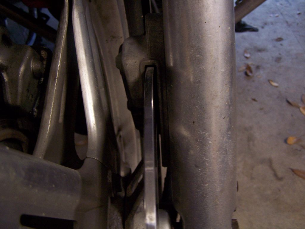

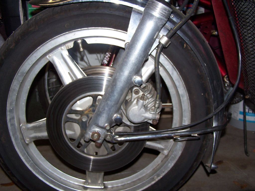

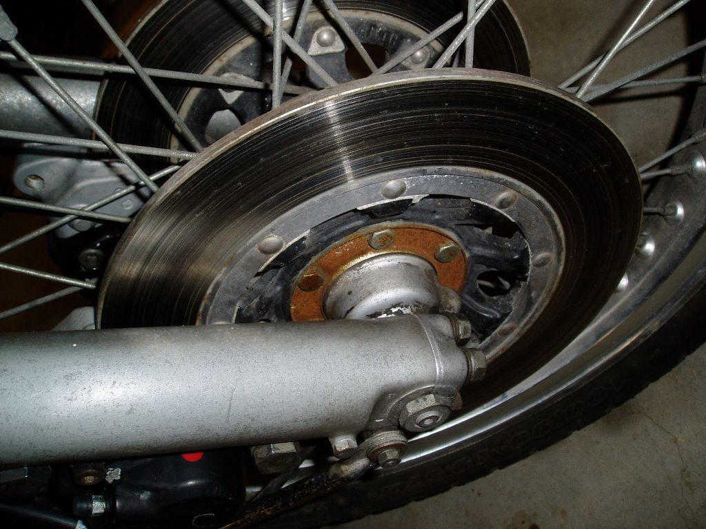

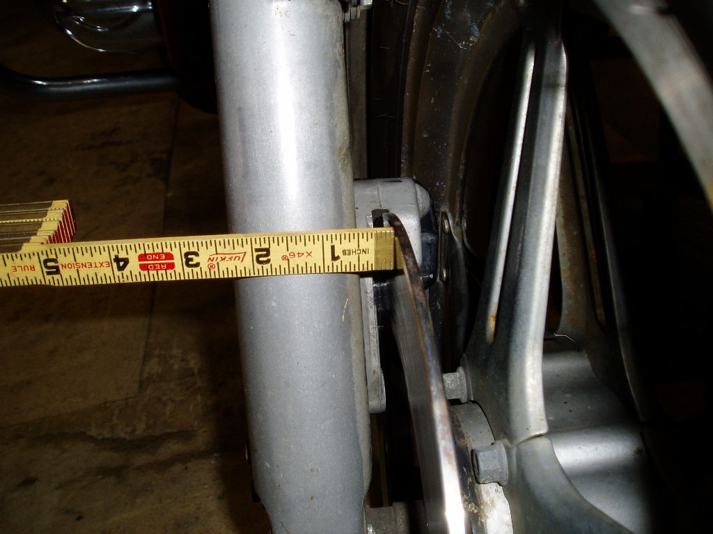

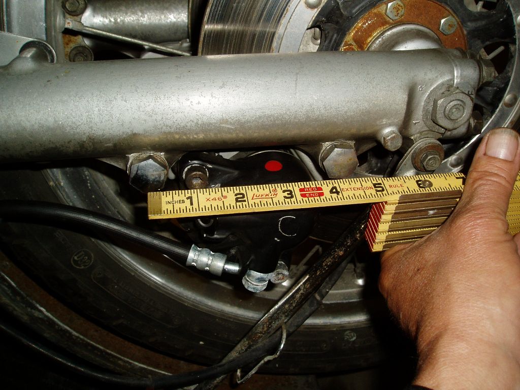

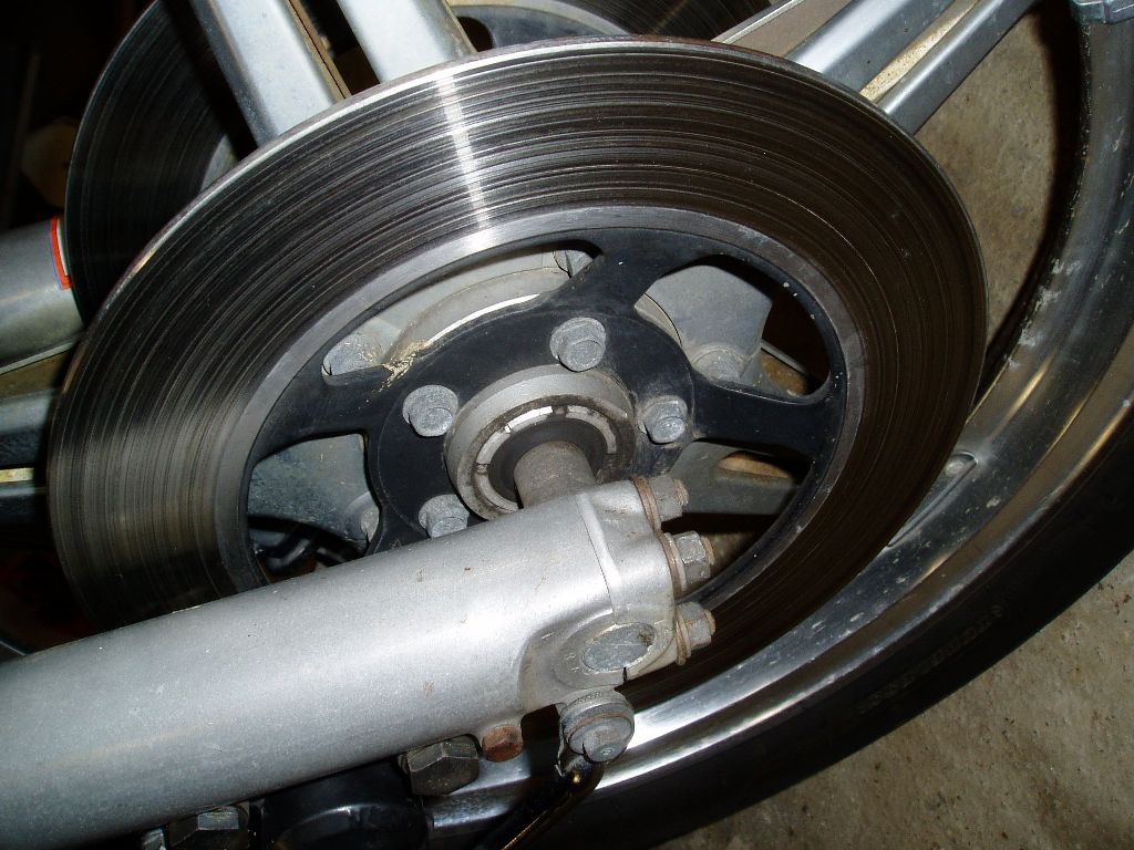

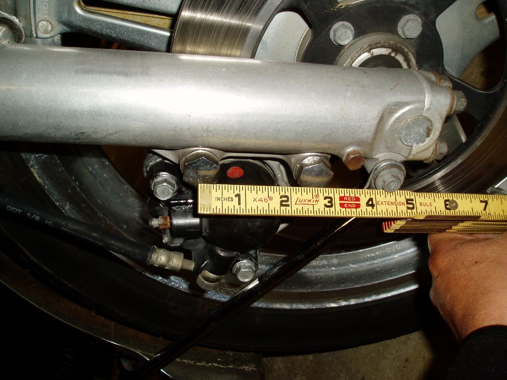

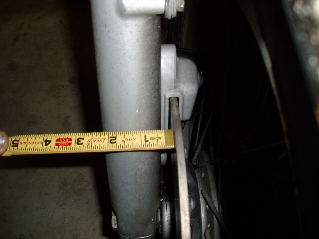

They are wrong. The Caliper offset and position/ mounting is different. The Disc on a 78 are 5 holes and the 75-77 are 6 hole mounts. The caliper mount assembly is completely different. I will get some pics.
- Posts: 38087
78 Disc offset
76 Disc offset
78 Caliper mounts
76 Caliper Mounts
78 5 Bolt pattern
76 6 Bolt Pattern
76 Disc offset
78 Caliper mounts
76 Caliper Mounts
78 5 Bolt pattern
76 6 Bolt Pattern

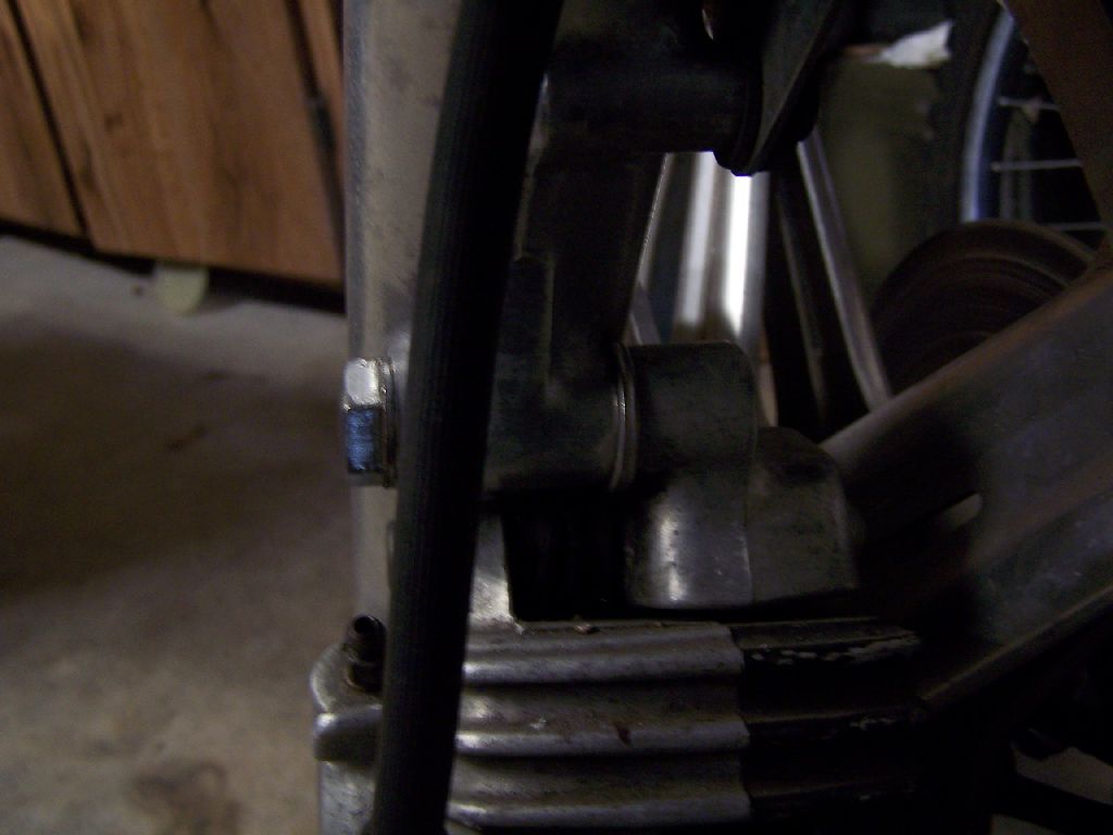

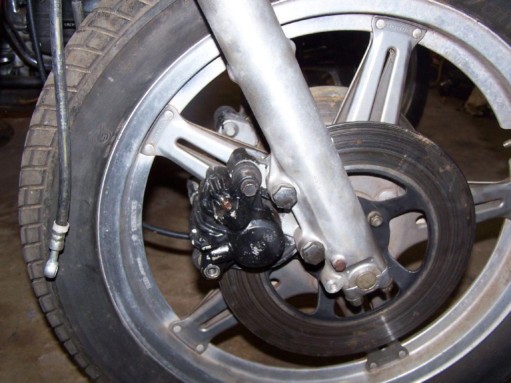

As for the front, if you unbolt the front wheel from a later 1000 (78,79), and transfer the whole assembly (wheel, rotors, and speedometer pickup) to the forks of an early 1000 (75-77) it will bolt right on. The only problem is the rotors on the comstar wheels are fractionally closer together than the rotors on the spoked wheels. To compensate I have a washer on each brake caliper mount bolts between the fork slider and the caliper mount. Trial and error to find the right thickness to line up the calipers with the rotors.
Washers on caliper mounts
Rotor lined up with caliper
76 fork slider with a 79 comstar mounted
78 slider with a 78 comstar mounted notice how much closer to each other the caliper mount bolts are

roncar, whiskerfish, thanks for the pics. They clearly indicate that the Comstars are not a straight bolt-on. I am MUCH clearer now.
