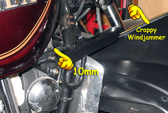

4. Take out the 2 - 10mm hex bolts holding the front of the shelter, one on the left and one on the right. Into bin #1 or back into the holes they came out of. I took off the crappy Windjammer and will be having a bonfire in my back yard.
5. Remove the two 12mm hex bolts from the outside of the rear shelter bracket. Into bin #1 or back in the holes.
6. Carefully lift the shelter, jiggle it left, jiggle right, rear up, rear down (in no particular order) until you can pull it clear of the bike. Store it someplace safe.

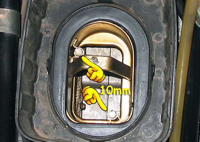

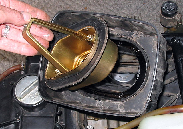

7. Spin off the wingnut, remove the top and lift out the filter. Fully loosen, but don't remove, the two 10mm bolts holding in the element retainer.
8. Lift up the airbox a bit so you can get to, and remove the two breather connections at the left and right rear.
9. Pull the whole thing out, bringing with it the airbox and rubber filter gasket.
10. Grab the seal that's still on the top of the carb set. Stack all that stuff up in the correct order, spin the wingnut a few turns and stow it on a shelf.

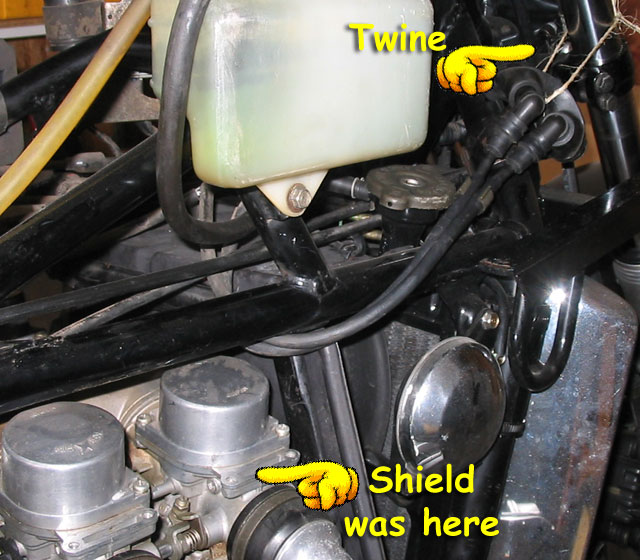

11. Yank off (synonyms for 'remove' please) the plug wires and tie them up and out of the way. That's bailing twine but you could use a piece of wire off your old wiring harness, some string or an old shoelace.
12. Remove the 8 - 8mm bolts holding the plug wire shields to the tops of the carbs, 4 per side. I started a new bin here for things in this new phase. So these go into bin #2.

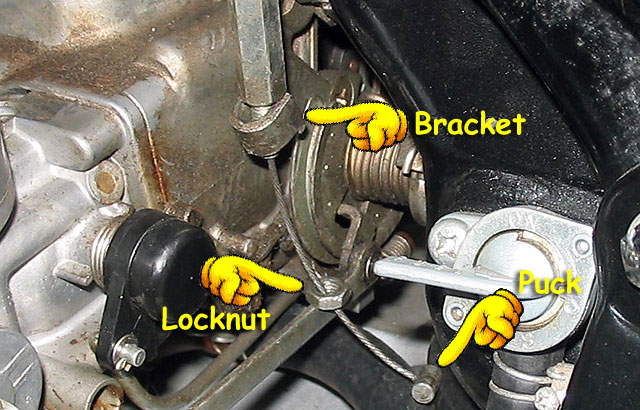

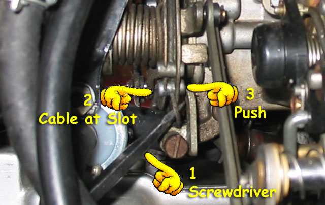

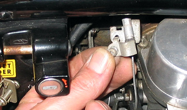

13. Remove the Phillips head screw and bracket that hold the choke cable. This is at the rear of #3 carb (that means; the rear of the right rear carb). Both pieces into bin #2.
14. Pull the cable toward you to line up with the slot and slide the little puck out. Shove the cable out of the way. (This same type of connection is used on both throttle cables.)

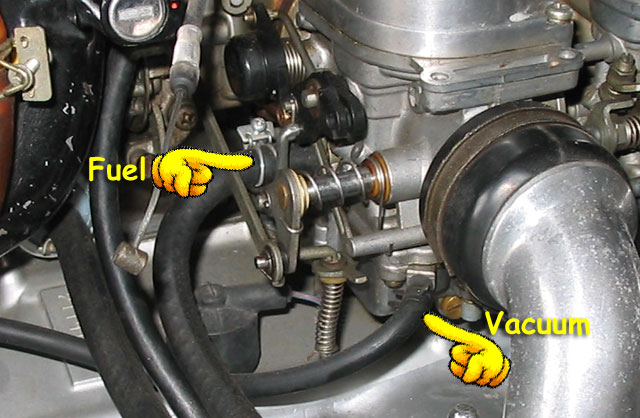

15. Disconnect the fuel and vacuum lines from the rear of #3 carb. Push them back out of the way.

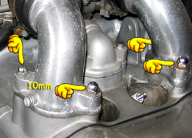

16. Remove the 8 - 10mm cap head bolts that hold the intake manifolds to the heads. There are two on each manifold. Bolts go in bin #2.
17. Pull up a little on an intake manifold and tap it lightly with a rubber hammer. The pair should pop off easily, don't pry with anything. Do the same on the other pair of manifolds.

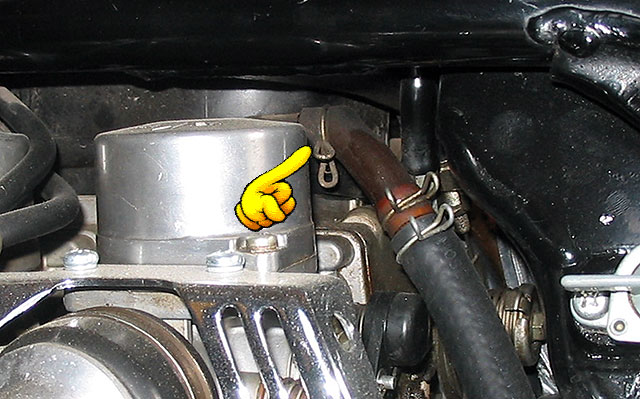

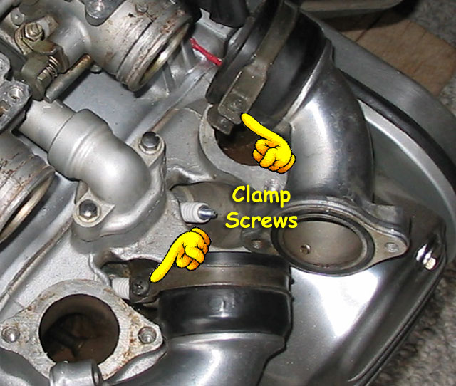

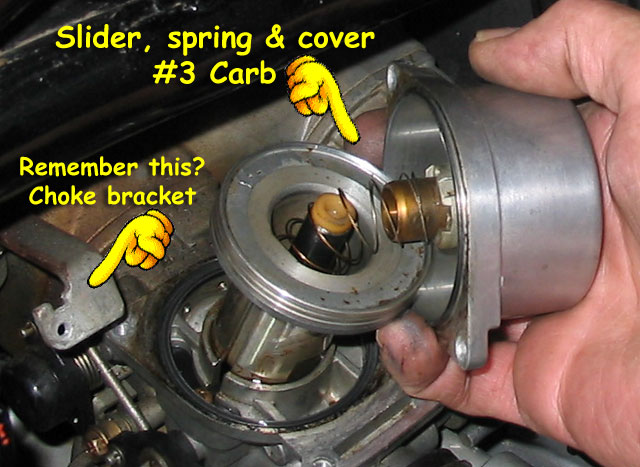

18. Loosen the Phillips head screws on the clamps that hold the rubber boots to carbs #1 and #3. Work the #1 and #3 manifolds, with their rubber boots, off of these two carbs.
19. Remove the two Phillips head screws on #1 vacuum chamber cover (top of the carb) and lift off the cover. Remove the spring and vacuum slide. Repeat for carb #3's cover. Keep these screws, slides and covers separate, number them, put them in special bins ... whatever ... they must go back into the same carb they came out of.

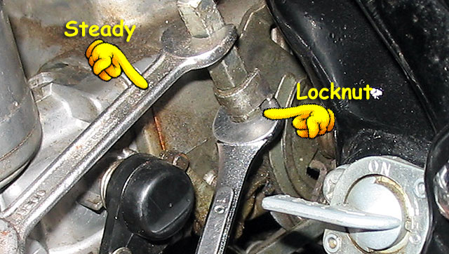

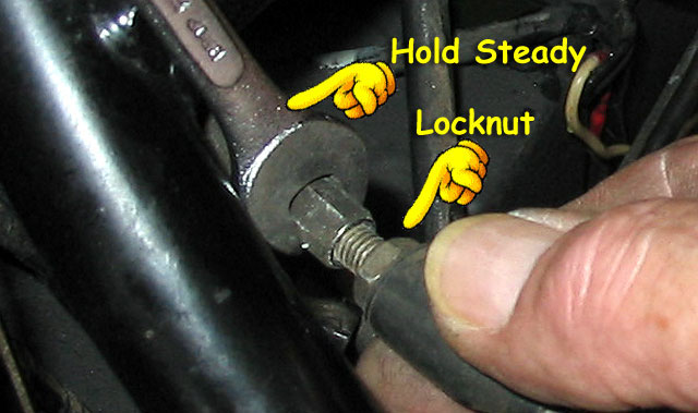

25. Using 2 - 10mm open end wrenches, hold the top of the throttle cable adjuster steady. Loosen the locknut at the bottom and turn it all the way off until it slides down the cable. It'll stop at the puck.
26. Work the adjuster out of the bracket and pull the cable free.

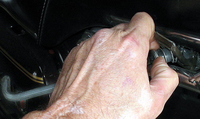

27. This other cable adjuster requires that you are a tiny Japanese person or a contortionist. I am neither, so I did a lot of cussing. Finagle your way down through the top and remove the second adjuster and locknut. Free the cable.

31. Get to the bench and replace the slides, springs and caps on carbs #1 and #3. Turn in the screws but not too tight.
