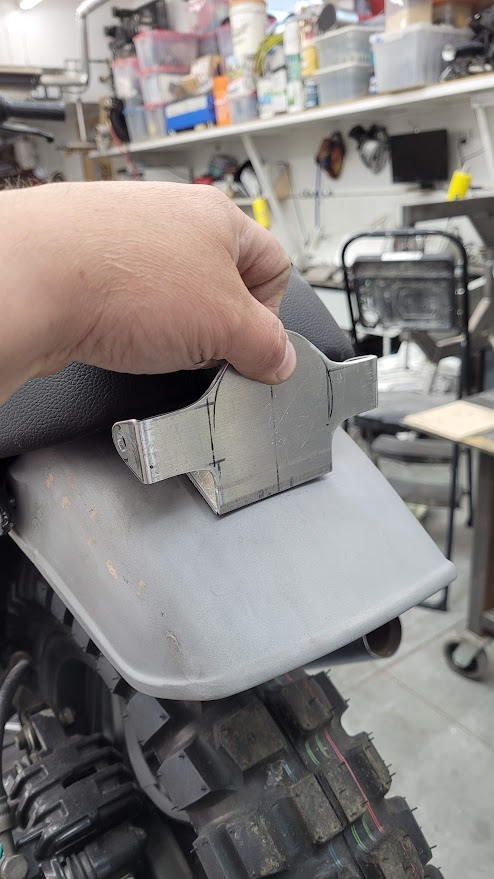

I finish welded up the rear fender and hit it with the hammer and dolly

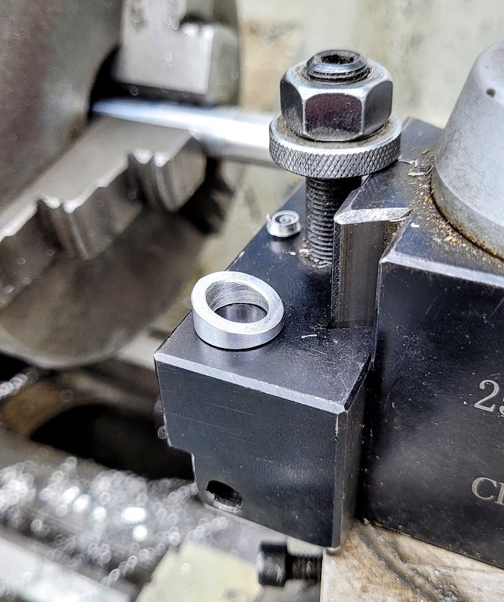

Then on to the signal lights. I had to make some wedge shaped spacers for the tiny little motogadget signals.
Turned out nice and clean and those tiny little signals are wicked bright!
Because the MER rally was fast approaching, I rushed through a crappy rear brake/signal assembly with an old stop light from a bin
Tiny little fender necessitated a separate license plate mount
