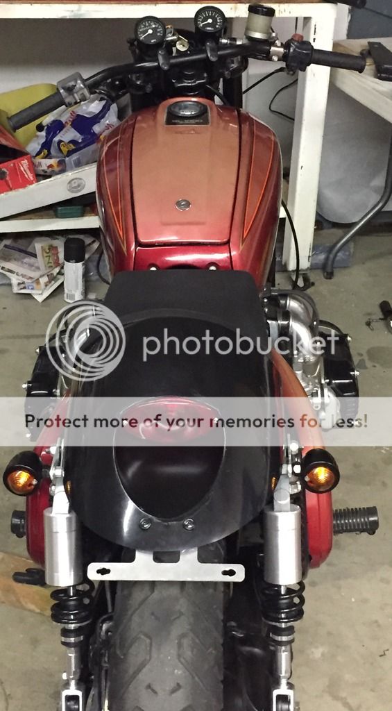

That's the reason I chose this tail section. It's rare to see one with a frenched in tail light on any cafe, and I like that it eliminates the "tail light hanging from the back" look and gives it a lighter more streamlined appearance. I'm really trying to make everything look as small and light as possible to draw all the attention to the big suitcase of a motorianstaley wrote:Great thanks for the pointer, too busy looking at the pictures. Thought Frenching went out with the Beatles. Real popular over here in the late 70's on cars that were customised. But I still love the idea.

I meant to ask in an earlier post where you got that tail section. I know you said you have a front fender modeled after a Ducati 750SS, but didn't see if you said where that came from.

The fender and tail section are both from Airtechwingrider wrote:I meant to ask in an earlier post where you got that tail section. I know you said you have a front fender modeled after a Ducati 750SS, but didn't see if you said where that came from.

Looking really good. Any chance those rear indicator light brackets could go behind the shock mount instead of over it?

I may mount them behind, I just have to figure out mounting the tail section to see where it'll fitEaster wrote:Looking really good. Any chance those rear indicator light brackets could go behind the shock mount instead of over it?
