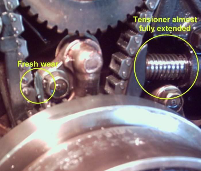

When the back cover of the engine is off look for signs that the camchain has been rubbing. The most common place for it to rub is shown in the pic below (this is my engine and was taken when I had it apart last summer)

The 650s have automatic camchain adjusters...
